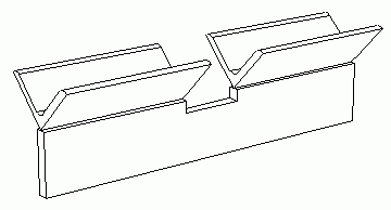

I have used my MIG welder to make extra long drill bits by butt welding a normal bit onto the end of a piece of steel rod. In those cases the rod was either the same diameter as the bit, or smaller. I beveled the ends of both pieces to create a sort of V shaped groove where they butt together, to help assure good penetration. I have a little jig I made to help keep the pieces aligned while welding. I made the jig by welding a piece of angle iron along to a piece of flat bar. Then I sawed out an area in the middle where the joint is made. I clamp the jig in a vise, then clamp each piece to be joined into the angles on the jig. If the pieces are different diameter you can shim under the smaller one to center them up.
After welding the pieces together I grind the weld flush with the OD of the largest piece.

One thing to check if you make a jig like that is that most steel angle has an inside radius where the legs meet. If the radius is larger than the pieces you want to align, it won't work as well. The size of the radius goes down with the size of the angle.

I was going to build one of those v jigs and then realized I have two, new, identical V blocks. Also, I guess two magnetic 90 deg angle blocks would work also or do you feel you definitely need to clamp the work?

Dave, I'm not sure if the magnetic hold is sufficient. My preference would be to clamp them because I'm a such a klutz once the welding hood is down. (I haven't got one of those nice auto-darkening hoods). Also as the weld cools there will be some tendency to pull sideways.

Yes they are machinists V blocks but they were pretty cheap around $20 for the two...I think...I have no other real use for them any way...at the moment...maybe when I get my welding skills up I will attempt to make your jig with some flat plate. Question...how did you cut the relief section? Hack saw?

Yes, a hacksaw, and a grinder. The angle is not welded in that area so the piece falls out when you saw through the angle. Actually just removing the piece of angle gives enough clearance to work, but if you want more you can grind into the base piece some. TomS38590.6552083333
